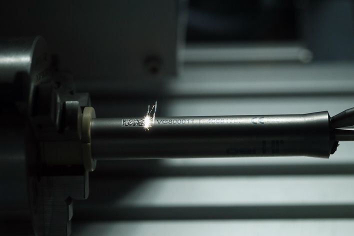

It didn’t take long to find the perfect candidate for marking: the small hydrocephalus valve itself. The valve marking is subject to strict UDI requirements: it must be corrosion resistant, readable by humans and machines alike throughout the lifetime of the device and biocompatible with zero contaminants in the material. “It’s a small part made of grade 5 titanium,” says Gleumes. “It has a polished, reflective surface that is also rounded, so it’s pretty much the worst-case scenario for a marking process!” Back in the TRUMPF application lab, engineers from the two companies came up with a process to tackle this challenging component. The USP laser produces what is known as a black marking – a nanopatterned surface structure that absorbs and scatters rays of light, creating an extremely dark, matt appearance without ablating any material.
“I was very impressed with the results,” says Gleumes. “The marking is perfectly readable in any light, whatever angle you look at it from.” This process leaves the metallic structure of the titanium surface virtually unchanged while maintaining full biocompatibility.

Black markings on tiny, curved surfaces.
