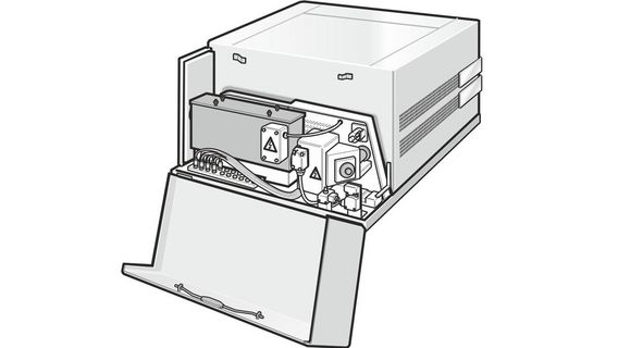

Integrated, encapsulated beam guidance of the TruFlow CO2 laser
Integrated, encapsulated beam formation
Optical elements can be integrated directly in the laser for beam formation in a space-saving manner, e.g. a phase shifter, circular polarizer, diameter adjustment mirror, or beam telescope. In this way, the output beam can be set individually. Due to the encapsulated design, the optical components stay clean, and the laser power and focus geometry remain absolutely constant.
