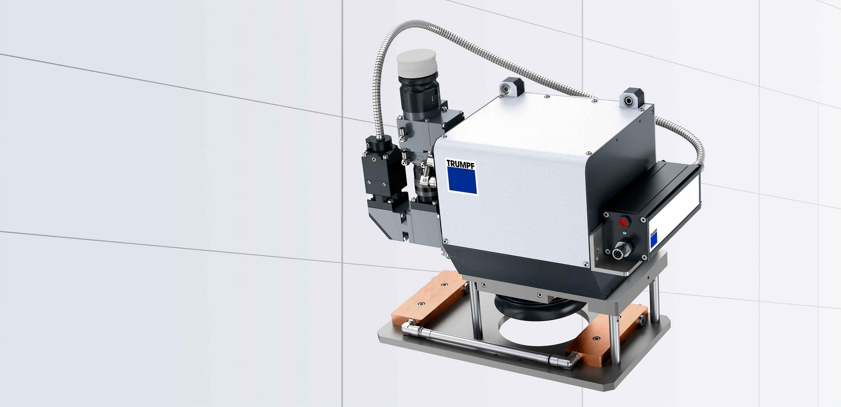

Optics with pyrometer (PFO 20-2 PO) and cooling elements
The programmable focusing optics from the PFO series are the ideal optics for remote processing. As they have their own work field, even relatively large surfaces can be hardened without the workpiece or focusing optics moving. With the integrated sensor system and control, you can work with complete process reliability, and always achieve an excellent level of quality.
