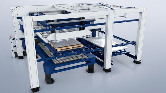

LiftMaster Store, fastest storage connection with multiple-machine connection
Automation
LiftMaster Store
Fastest storage connection with multiple-machine connection
LiftMaster Store Linear, fastest storage connection with multiple-machine connection
Automation
LiftMaster Store
Option LiftMaster Store Linear
The frame solution, LiftMaster Store, is directly connected to the store and requires minimal space. In return, it offers more latitude to design your production to meet your specific needs. Here, the LiftMaster Store is assisted by a number of tried-and-tested TRUMPF technologies. Examples include the suction frame with unloading rakes for automated loading and unloading, or the synchronous loader for increased productivity. With the independent pallet picker crane, the LiftMaster Store can quickly access pallets in the store. This makes it particularly well suited to automated scrap skeleton separation. Connection to up to three machines with multiple tool stations is possible with the LiftMaster Store Linear.

The LiftMaster Store accesses the store directly via a pallet picker crane.

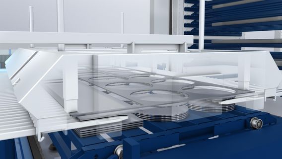

LiftMaster Store, scrap skeleton separation
Scrap skeleton separation
The LiftMaster Store quickly separates finished parts from the scrap skeleton. For this purpose the suction frame is additionally equipped with spreadable grippers which pick up the scrap skeleton with the unloading rake. The finished parts remain in the closed unloading rake and can be placed down in an unloading area. The suction frame then sets down the scrap skeleton. This option is only available for the LiftMaster Store 1530.

Suction frame/unloading rake
The unloading rake takes the finished, processed sheet from the pallet changer and sets it down in the unloading area. The suction frame is fitted with individually controllable suction cups that pick up the unprocessed sheets from the loading area, and set them down onto the pallet changer.
