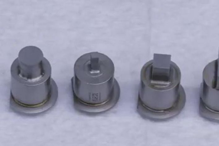

Imagine, for example, being able to create an oblong hole with every conceivable orientation in the sheet metal – with just one tool! This is really easy if you can rotate the punch by 360°. Of course, this works with all contours that you have a tool for – regardless of whether it is a standard or special tool. The ability of all your tools to rotate multiplies your processing options and reduces your tool requirements – and therefore your costs.
Principle of tool rotation (Source: TRUMPF)
