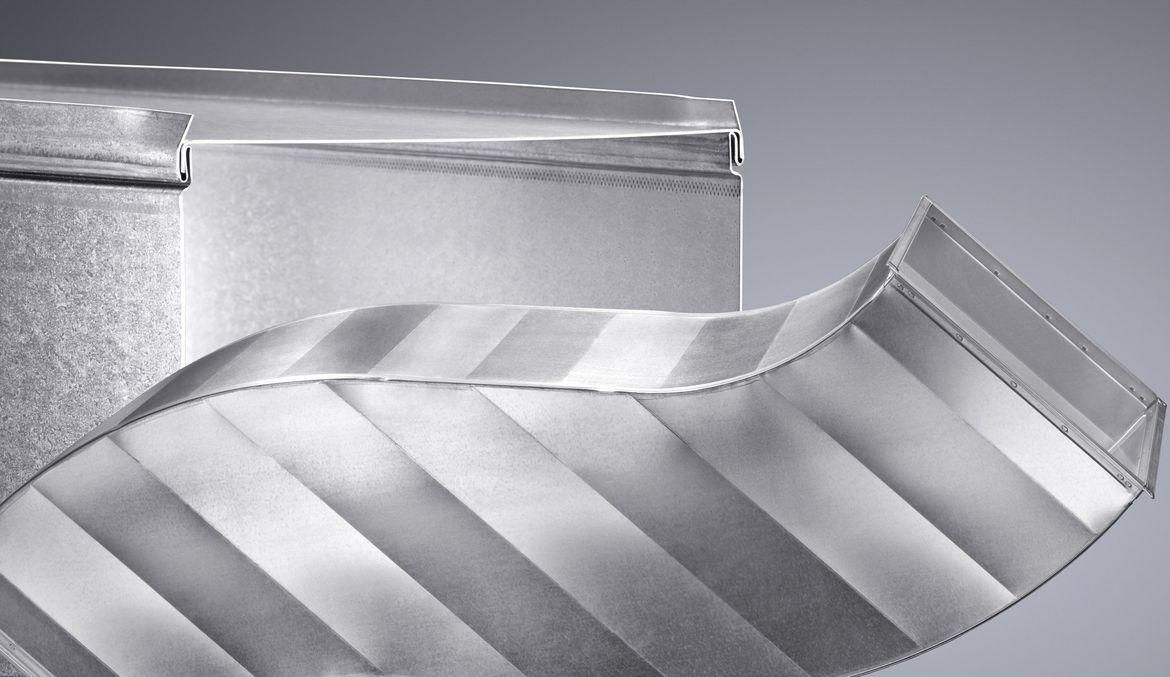

The TruTool F 300 with 1700 watt motor is the perfect machine if you prefer to work in the sheet thickness range starting from 0.04 in. for mild steel. You can close Pittsburgh seams on straight or curved ducts perfectly with its powerful motor and matching high working speed. The adjustment to sheet thicknesses of 0.75 mm – 1.25 mm in mild steel is automatic. You therefore achieve high-quality, tightly joined seams.
Powerful
The 1700 watt motor provides fast and effortless processing of high sheet thicknesses.
Flange height and sheet thickness
Suitable for flange heights of 9 mm – 13 mm and for sheet thicknesses of 0.75 – 1.25 mm.
Excellent process reliability
Automatic adjustment to the sheet thickness gives you consistent seam results.
Area of application
With the TruTool F 300 with 1700 watt motor, you can close seams on straight and curved ducts.
