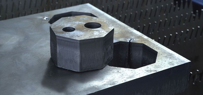

[AUTO-CREATED FROM en_US]: Cutting Capabilities with 24 kW of power
