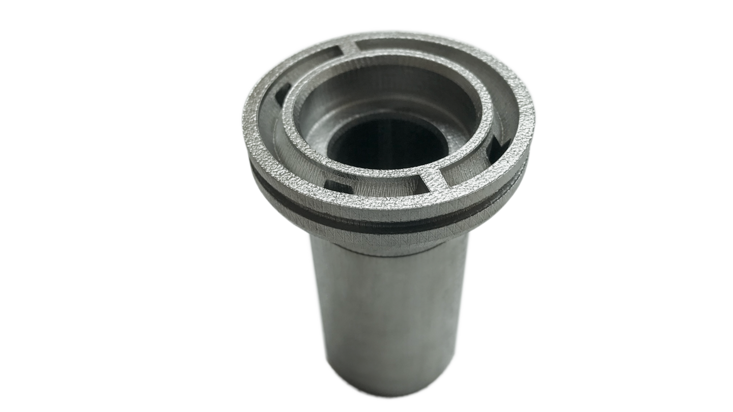

Amorphe Expansion Sleeve
One part that can be improved by 3D printing amorphous metals is an expansion sleeve. Thanks to the high elasticity of the amorphous material, it deforms more readily than a conventional sleeve. 3D printing makes it possible to produce the part in one piece instead of making components one by one and then assembling them. This simplifies the production process. (Source: Heraeus AMLOY)
