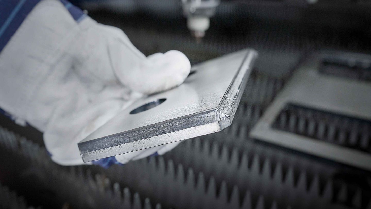

Bevel Edges
The TruLaser Series 3000 Bevel Cut Edition optimally prepares welding edges by automatically generating beveled cut edges on the contours of parts while cutting. (Source: TRUMPF)

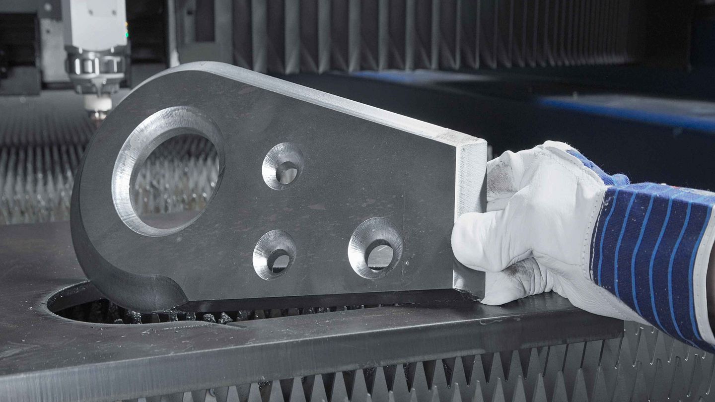

Complex Geometries
The TruLaser Series 3000 Bevel Cut Edition also produces complex bevel geometries and countersinks without problems. (Source: TRUMPF)
