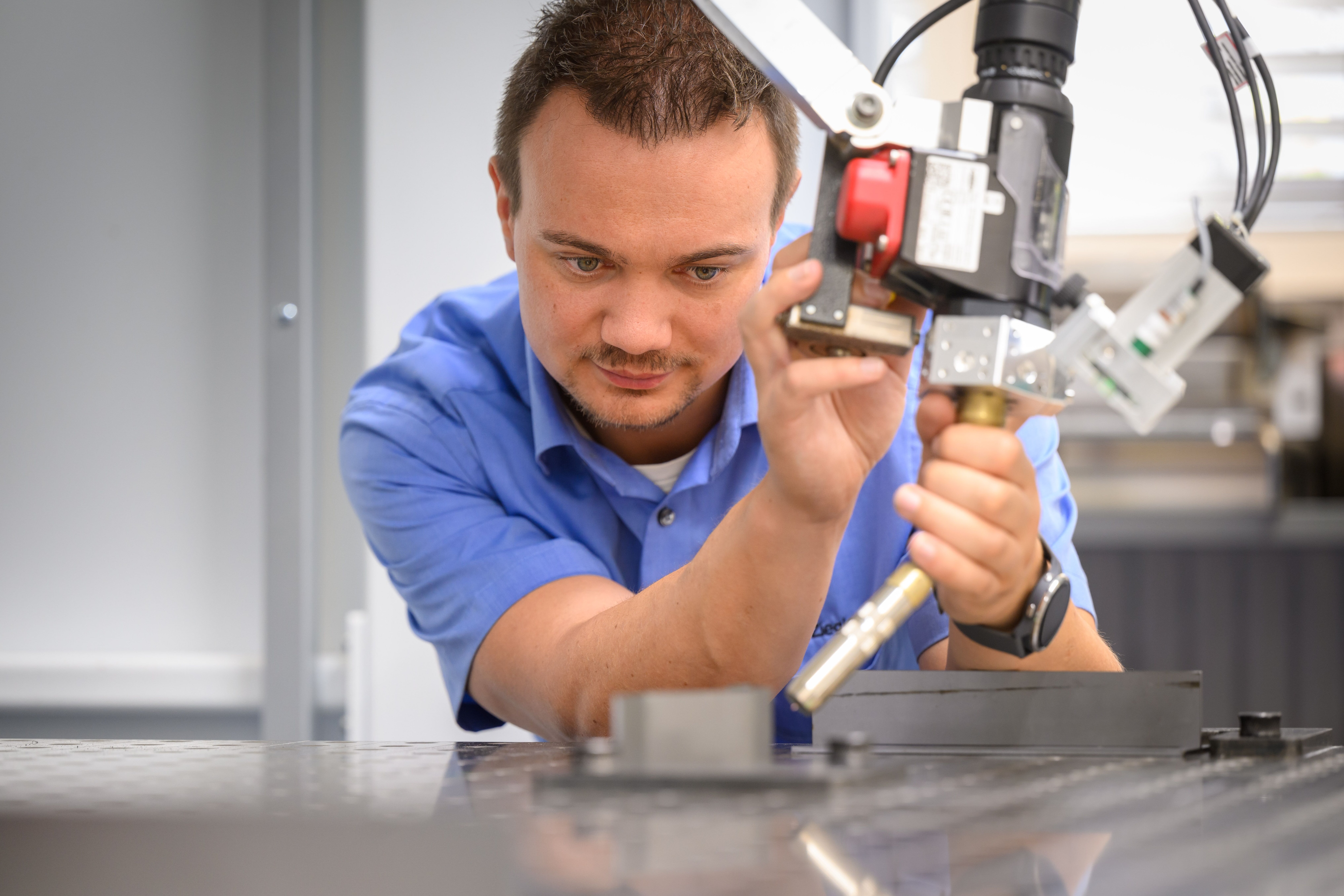

Robot with Smart Seam Weld Tracking
With Smart Seam Tracking from TRUMPF, the TruArc Weld robot calculates its own welding path.
Easy programing of TruArc welding robot
With Smart Seam Tracking, the welding robot can be programmed within seconds, even for complex components. This reduces strain on employees and counteracts the shortage of skilled workers.
Bringing the TruArc Weld Robot into start position
Instead of teaching each welding spot individually, the employee only needs to bring the robot into the starting position. The rest is done by the technology.
