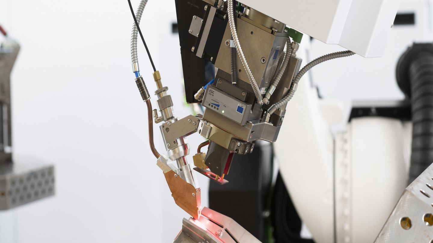

BrightLine Scan
TRUMPF's new BrightLine Scan technology enables the laser beam to be guided by the robot and laser scanner simultaneously. (Source: TRUMPF)

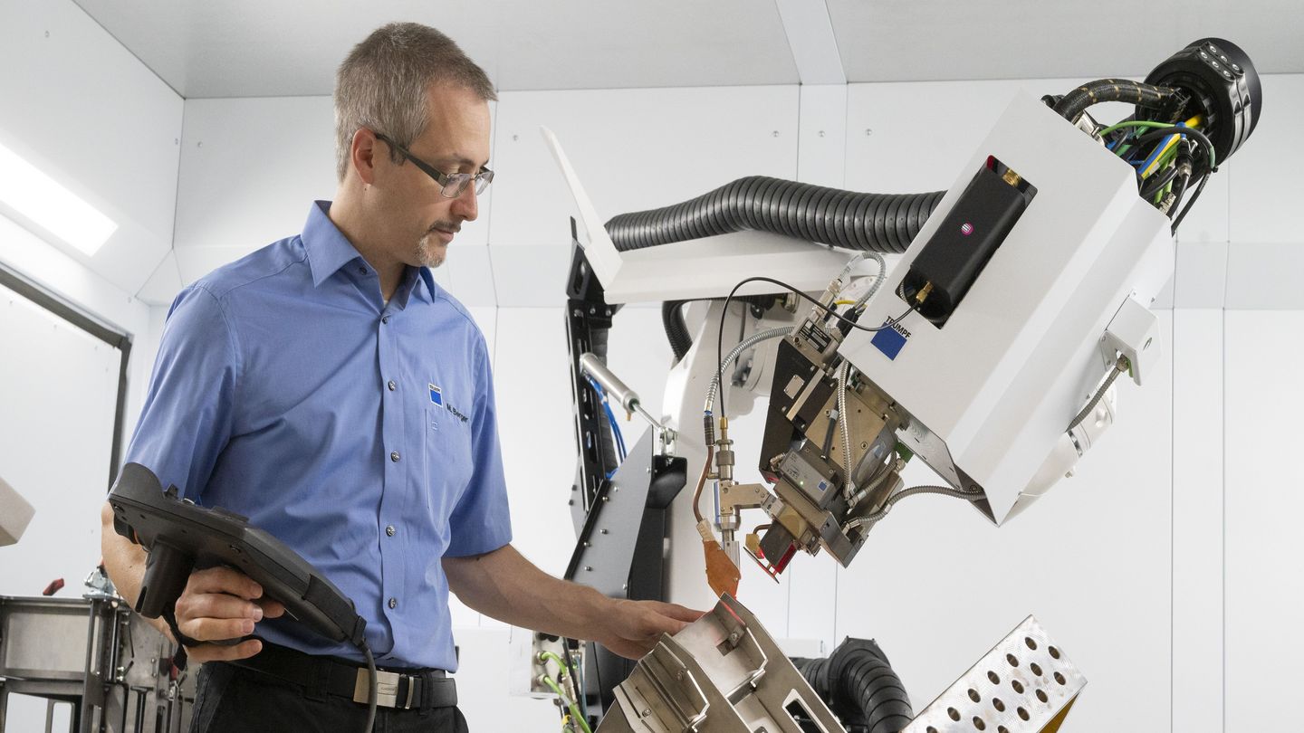

Laser Scanner
The laser’s focusing optics are freely programmable with TRUMPF's BrightLine Scan technology. TruLaser Weld users have the parameters they need for all the most common applications. (Source: TRUMPF)
