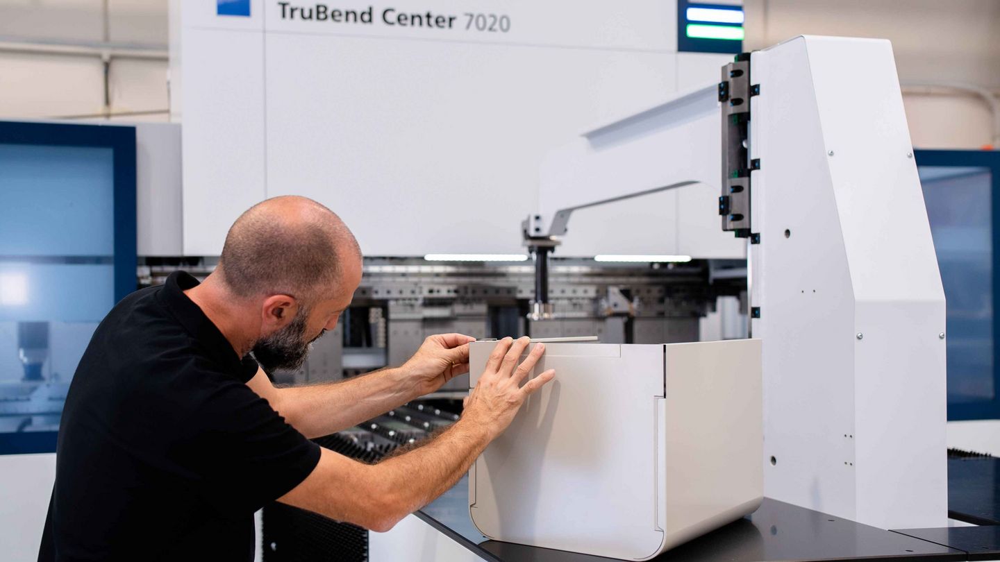

TruBend Center 7020
The TruBend Center 7020 allows users to harness the benefits of panel bending for complex geometries. (Source: TRUMPF)

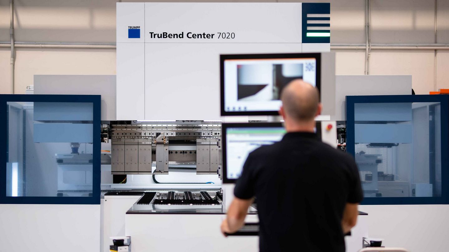

Easy to use
With the TruBend Center 7020, it only takes a few clicks to create a bending program on the computer. (Source: TRUMPF)

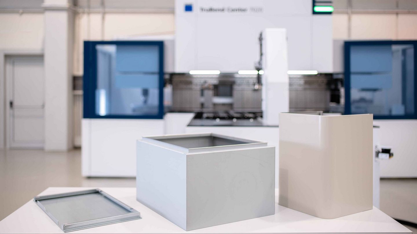

Applications
The TruBend Center 7020 is the perfect choice for producing large electrical cabinets for machines or for the construction industry. (Source: TRUMPF)
