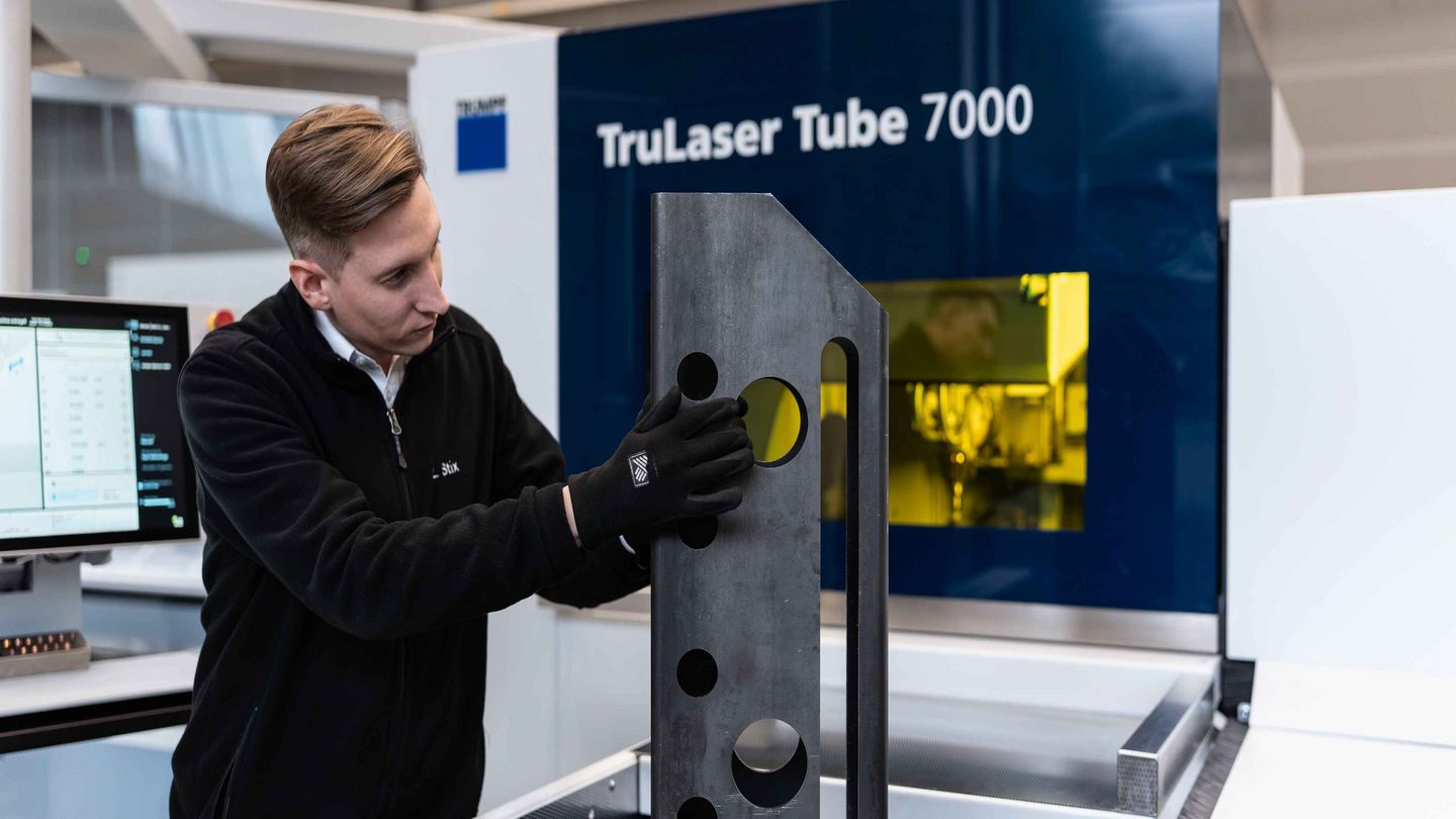

TruLaser Tube 7000: Highest part quality
Several new systems ensure maximum process reliability and part quality on the TruLaser Tube 7000. (Source: TRUMPF)

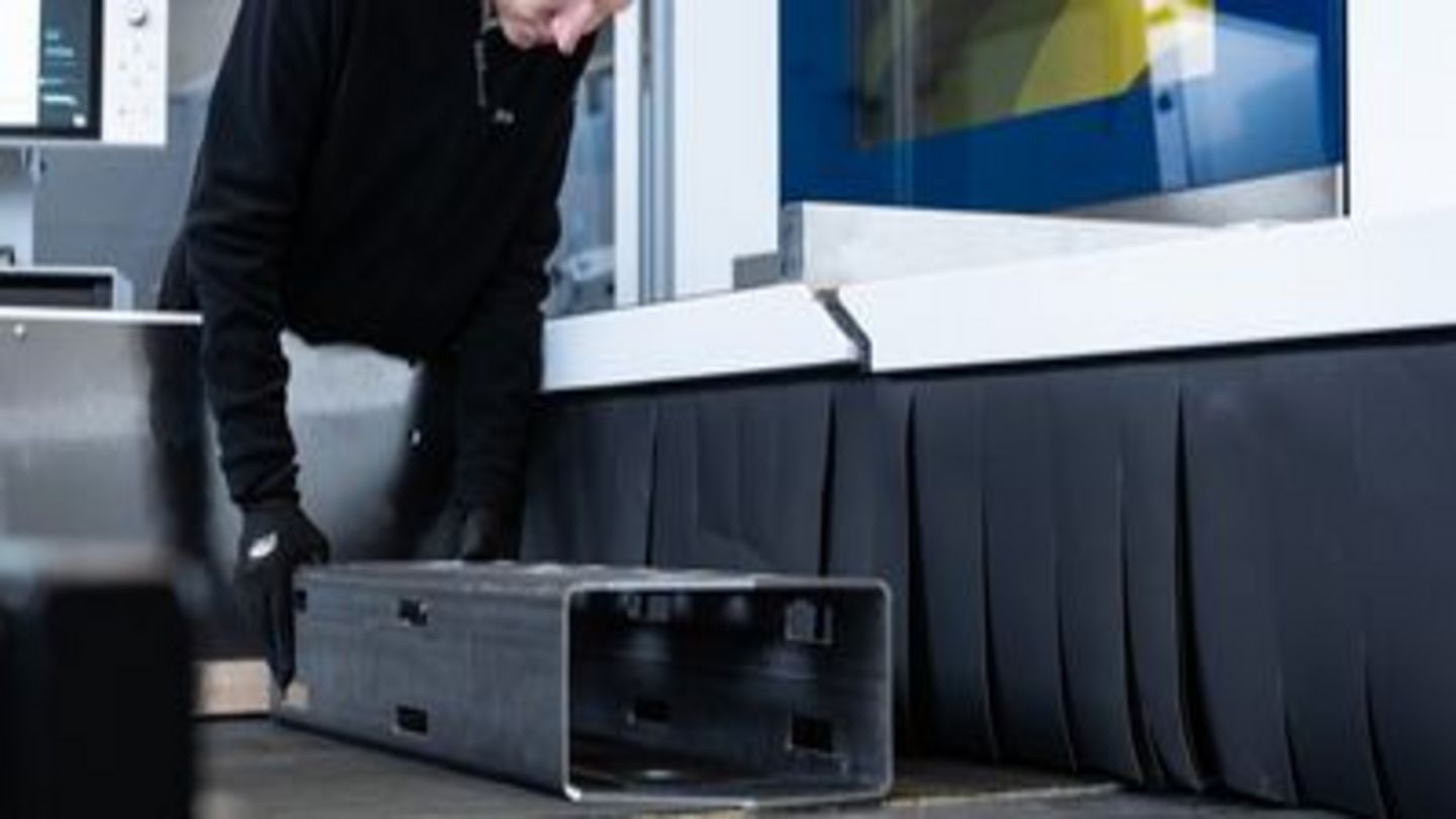

TruLaser Tube 7000: High Flexibility
With its extended envelope circle, the TruLaser Tube 7000 processes small and large components quickly and flexibly (Source: TRUMPF)
