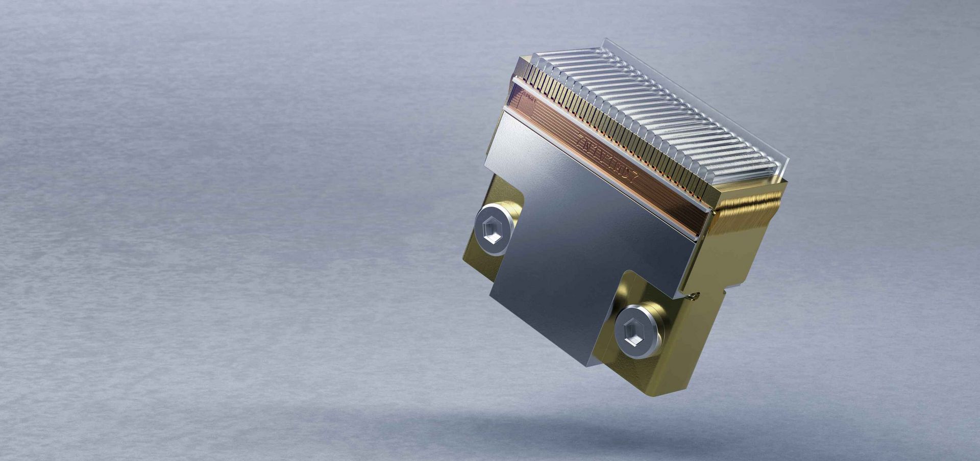

Surface mountable laser stacks (SUMO)
Stacks suitable for surface mounting where electrodes are on the side of the emitting area.
These compact pump sources for high energy lasers have a flexible design with the ability to scale the number of bars per stack and increase peak powers.
This conduction cooled stack is designed for low duty cycle (< 1%) operation and can provide > 5 kW peak power  depending on the operating mode.
We work with you to design a form factor – size, pitch, laser power, heat load, beam quality, optics – to meet your requirements.
High-density configurable laser stacks (HIDEC)
These stacks are specially designed to enable high-density 2-D array stacking with the cooling and electrical connections under the emitting area.
This stack is designed for low duty cycle (< 1%) operation and can provide very high peak powers (1 kW/bar) and with a small bar-to-bar pitch. The build standard allows it to achieve high lifetime and performance levels for the most demanding applications.  Available in both conduction cooled and water-cooled formats.
