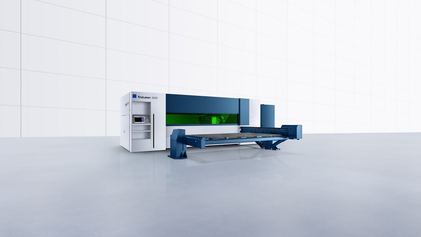

TruLaser 2030 fiber
TruLaser 2030 fiber combines the advantages of a compact machine with the performance of higher machine classes.

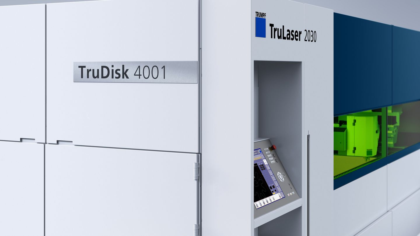

TruDisk
With a TruDisk laser, TruLaser 2030 fiber offers all the advantages of solid-state laser cutting. The machine is available with two, three or four kilowatts of laser power.

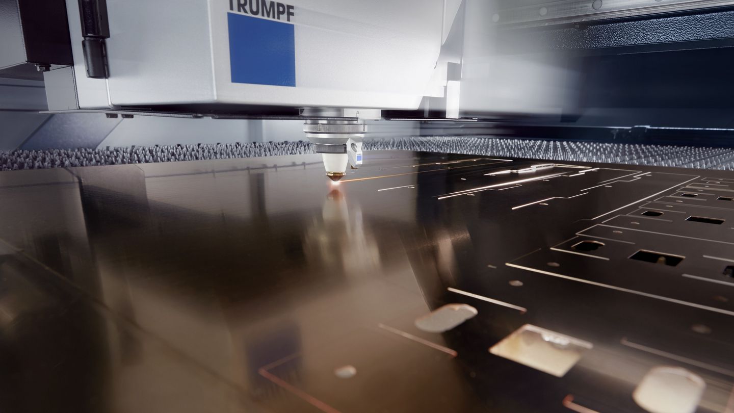

Nozzle changer
The nozzle changer with eight spaces precisely replaces the nozzle in the cutting head on a fully automated basis. This reduces non-productive times.
Collision protection
The collision protection avoids damage to the cutting head in the event of collisions with tilted parts.

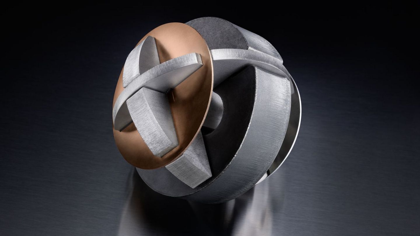

Non-ferrous metals
Thanks to the robust TruDisk solid-state laser, the TruLaser 2030 fiber can even cut highly reflective materials such as copper using nitrogen.

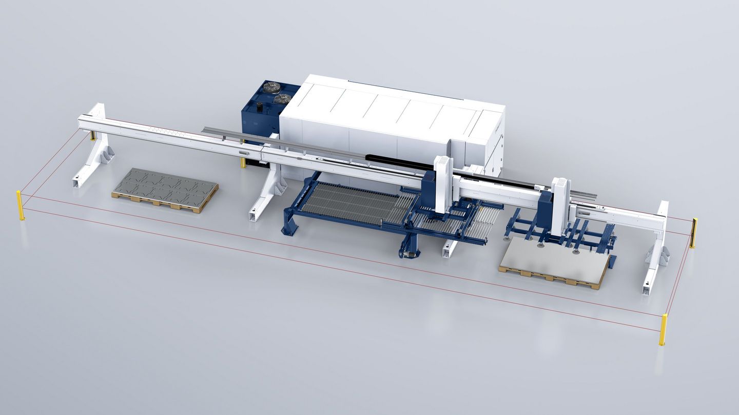

TruLaser 2030 fiber with LiftMaster Shuttle
LiftMaster Shuttle transforms the TruLaser 2030 fiber into an automated production system.
