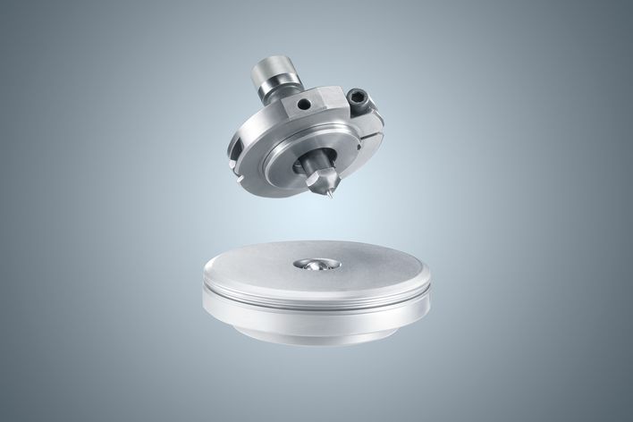

Using the patent-registered film slitting tool with ball tip, you can slit films quite simply on your punching or punch laser machine. The ball tip penetrates the film and glides over the sheet in the process. The film is thereby slit perfectly and flawlessly without scratches or marks damaging the sheet. The die with ball insert ensures low-scratch processing underneath the sheet. The film slitting tool is above all useful when stainless steel is being used, for example, with doors, switchboards or display boards or for sheets which are partially painted.
Punching tools
Film slitting tool
Slit films flawlessly
Neatly slit protective films
Using the film slitting tool, you can slit protective films on your punching or punch laser machine, without damaging the sheet.
Flawless cutting
Thanks to the spring-loaded punch, the film slitting tool cuts films without damaging the sheet.
Long service life
The ball tip of the tool is low-wear and therefore ensures a long service life.
Flexible
Due to the large spring range of the tool, it can adjust to any film thickness.
Diverse contours without limits
The design of the tool also makes the smallest slitting contours possible.
