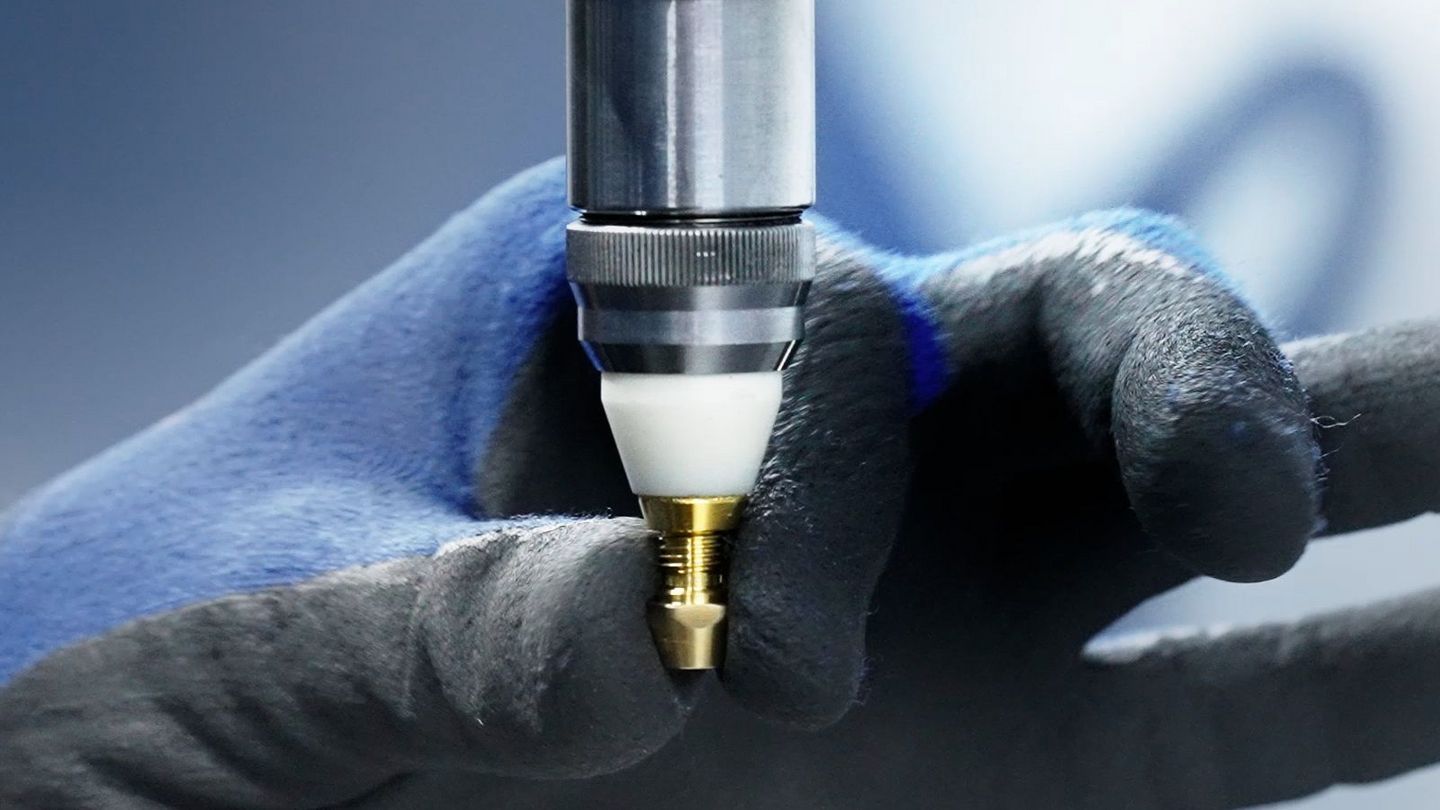

Users benefit from reduced machine downtime and fewer service interventions as a result of the new solution. The heart of the new solution is a new cutting nozzle, the X-Blast 2.0. The new nozzle design allows the nozzle-to-sheet distance to be increased to several millimeters. This significantly reduces the risk of collisions between the nozzle and the sheet during the cutting process.
“Nozzle collisions were previously a frequent source of disruption, particularly when users laser cut with compressed air as the cutting gas. The collisions sometimes led to damaged nozzles, fluctuating cut quality, and unplanned machine downtime,” says Kohllöffel. "In tests, the new nozzles were in use for more than three months without needing to be replaced. The typical service life of the already improved X-Blast standard nozzles was previously just a few days. Now, even with less-than-ideal programming or fluctuating production conditions, the cutting process remains stable, regardless of whether compressed air is used as the cutting gas.”

New cutting nozzle
The heart of the new laser solution is a new cutting nozzle. (Image: TRUMPF)
