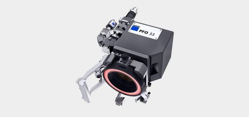

Programmable focusing optics
The ideal optics for remote processing
Programmable focusing optics PFO 20
PFO 20
Welding and drilling with the programmable focusing optics PFO
Programmierbare Fokussieroptik PFO 33 (KF023)
PFO 33
For applications with a laser power of up to 12 kW
