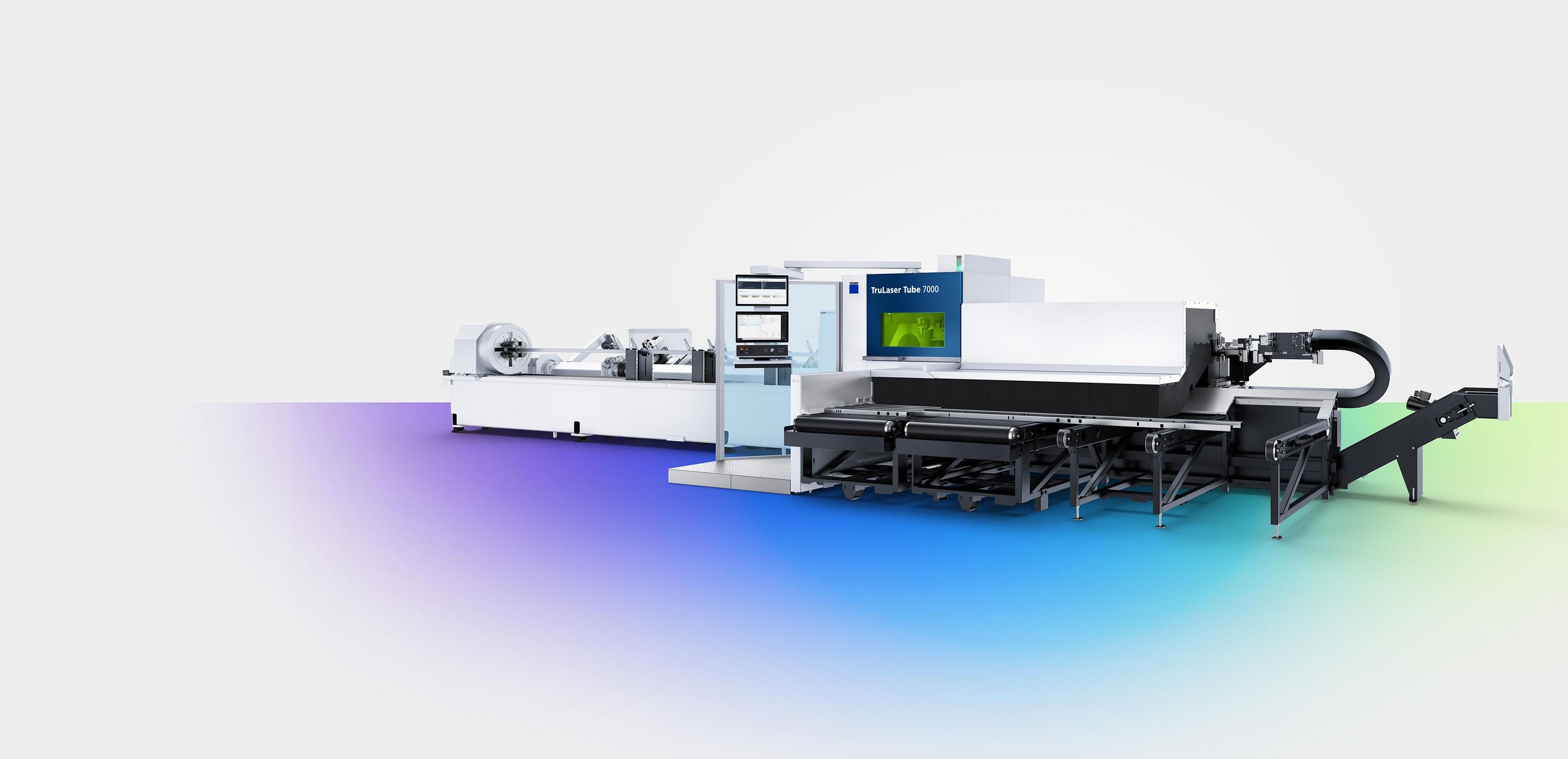

TruLaser Tube 7000
The flagship - uncompromising in all dimensions
October 20–23, 2026 | Hanover, Germany | Hall 11, Booth 11-B70 + 11-B94
Experience this machine live at EuroBLECH!
Secure your free trade fair ticket now. We look forward to your visit!
Maximum productivity in the entire volume segment with minimum set-up and programming effort.
The TruLaser Tube 7000 is your flagship in laser tube cutting. With this laser tube-cutting machine, you can process round tubes up to a diameter of 273 mm, rectangular tubes up to an outer circle of 290 mm and square tubes up to 203 x 203 mm with great flexibility - and much more productively than typical systems in this class.
The laser tube-cutting machine not only impresses with its robust design. It automates many inspection and correction steps and ensures quality directly in the cutting process. ScanLine, ObserveLine Comfort and ObserveLine Edge monitor raw material and cutting areas. They identify tolerances, residual slugs and pre-punched contours and take targeted action. This reduces manual checks and reworking. Process reliability and the good parts rate increase significantly.

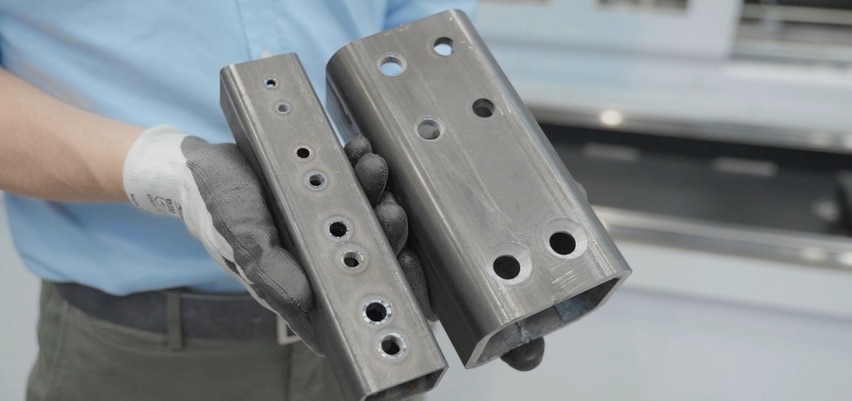

Tapping, flow drilling, countersinking, and twist drilling – all performed directly during the process – reduce the need for subsequent processes, minimize parts handling, and eliminate sources of error.

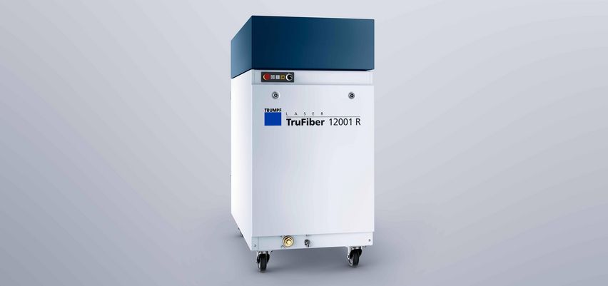

TruFiber 12001 for maximum feed rate​
Thanks to TRUMPF laser power control, you can deliver the optimum, high laser power to the tube. ​
Take advantage of feed rate increases of up to 300% and maximum parts output.​
Technology package for tapping - integrating processes
Integrate tapping, flow drilling, countersinking, and twist drilling directly into the tube laser, and set up to 12 tools in the tool changer. The integrated work steps reduce subsequent work steps and parts handling, reduce the possibility of errors and thus increase the added value of a machine.

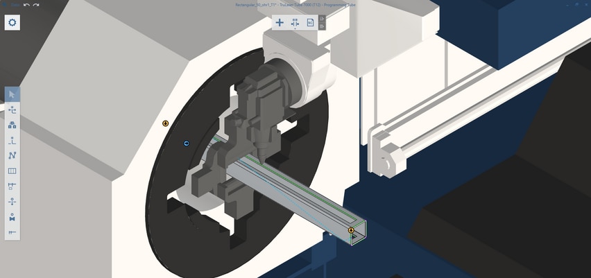

Programming Tube: reduce programming time​
With Programming Tube, AutoRun takes you from a CAD model to a finished NC program in seconds.
With the integrated 3D CAD Tube Design, you can import common file formats and design tubes and assemblies. Innovative tube designs, such as ​bend connections and connecting elements, are created at the push of a button​.

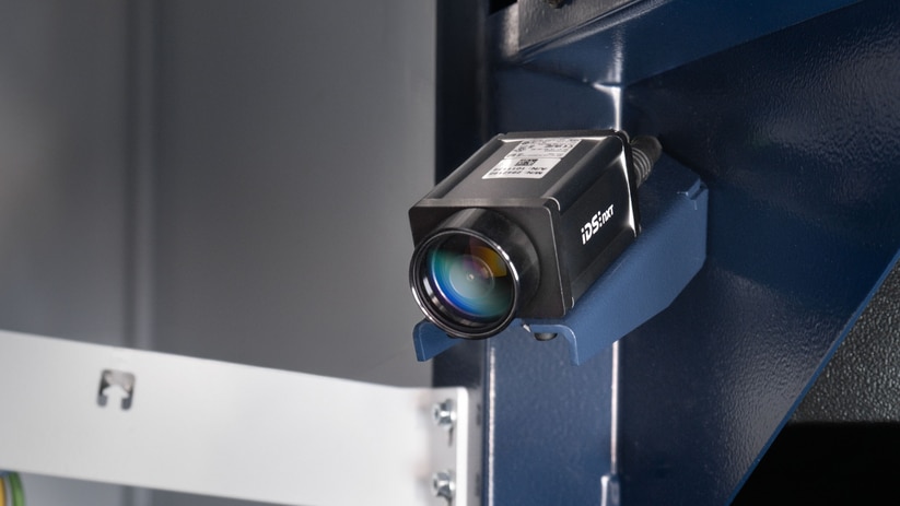

Vision Equipment – live and remote​ transparency
Vision Equipment with Smart View displays the Trulaser Tube 7000 from both the inside and outside in real time – either at the machine or remotely. Multiple cameras provide different perspectives. Enabling you to keep an eye on the machine at all times, regardless of where you are.​

Technology package for tapping - integrate processes
Integrate flow drilling, tapping and twist drilling directly into the tube laser. The integrated work steps reduce subsequent work steps and parts handling, reduce the possibility of errors and thus increase the added value of a machine.

TruFiber 12001 for maximum feed rate and thicker wall thicknesses
To ensure the kilowatts actually reach the tube: Thanks to TRUMPF laser power control, you can deliver the optimum, high laser power to the tube. Take advantage of feed rate increases of up to 300% and the ability to process wall thicknesses of up to 20 mm mild steel.

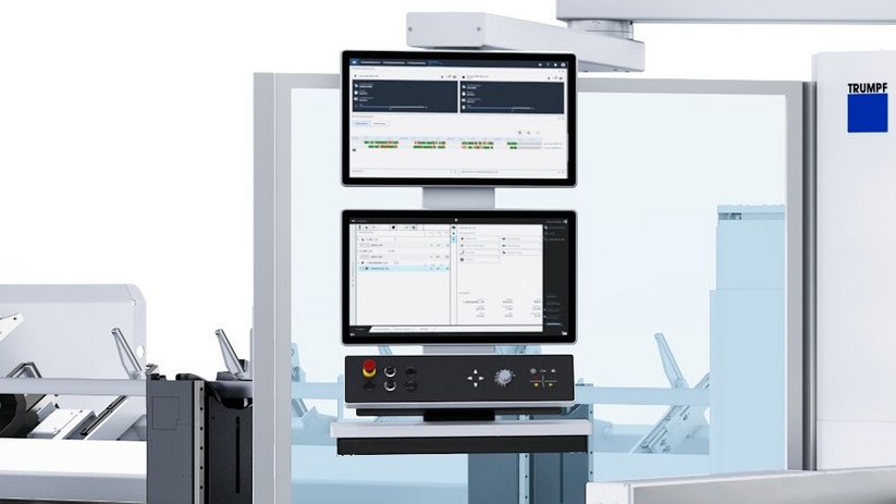

Touchpoint HMI: Better overview, fewer clicks​
The new control panel adds a second 24-inch touchscreen to the Touchpoint HMI. You can view web-based content from TRUMPF Smart Services and Oseon directly at the machine.​

Programming Tube
Using the 3D software Programming Tube, you can quickly, easily and intuitively create NC programs. Strong automated processes reduce the time and effort needed for programming. The software offers flexible data import procedures and efficient design – and provides step-by-step support.
