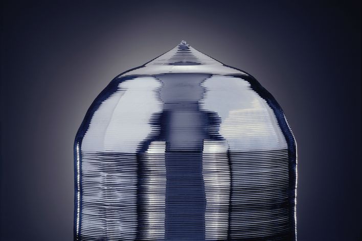

Crystals grown as per the Czochralski process
Czochralski process
The Czochralski process is the most common crystal growing technology. The single crystal is pulled from a melt that is located in a crucible. For silicon, the crucible undergoes resistance heating. Higher melting crystals (sapphire) use inductively heated crucibles with graphite casings. Using a rotating seed crystal immersed in the melt, the single crystal is pulled at several millimeters per hour. It is vital here to avoid any temperature fluctuations. Generators therefore need to deliver constant output power over extended periods of time. Between 20 and 100kW of power at frequencies of around 15kHz are required.
