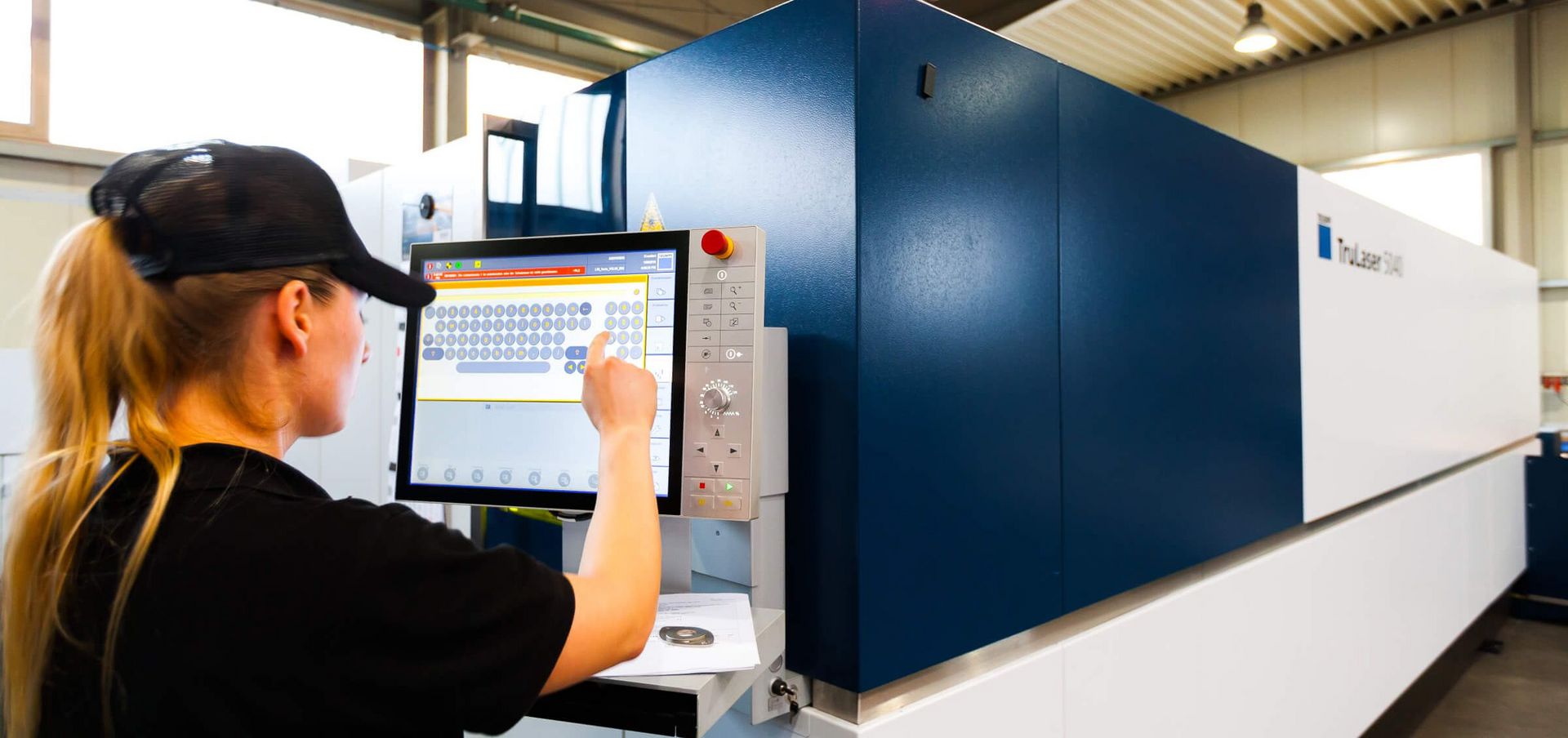

The TruLaser 5040 fiber has also exceeded all expectations when it comes to its operating convenience. During three days of training, operators were able to try out all the many programming options right away. (Picture: Thomas Abé)

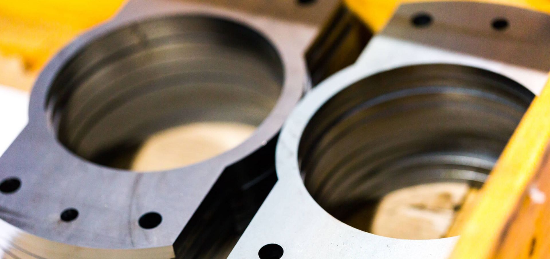

Thomas Sattler: “The relationship of bore diameter to sheet thickness is fantastic, and we can mostly do away with the extra milling we had to do in the past.” (Picture: Thomas Abé)
Sattler is also impressed by having the option of drilling small holes in steel sheets 20 millimeters thick: “The relationship of bore diameter to sheet thickness is fantastic, and we can mostly do away with the extra milling we had to do in the past.” He has also been impressed by the BrightLine fiber, FlyLine and automatic nozzle changer functions. “Thanks to BrightLine fiber fusion cutting, we can achieve a high-quality edge when cutting stainless steel, even when the contours are tight. FlyLine allows us to process thin sheets faster than ever before. And, because we’re always changing from thick to thin sheets, the automatic nozzle changer saves us additional processing time – and the 8 kW laser is lightning fast as it is,” he says.

The TruLaser 5040 fiber has also exceeded all expectations when it comes to its operating convenience: position, plug and play. “We had three days of training here at our manufacturing facility, which allowed us to try out all the many programming options right away,” says Kummerer. “The programming itself is the same as for other TRUMPF machines, but there are significantly more options to choose from because of the sheer scope of what the tool can do.”
