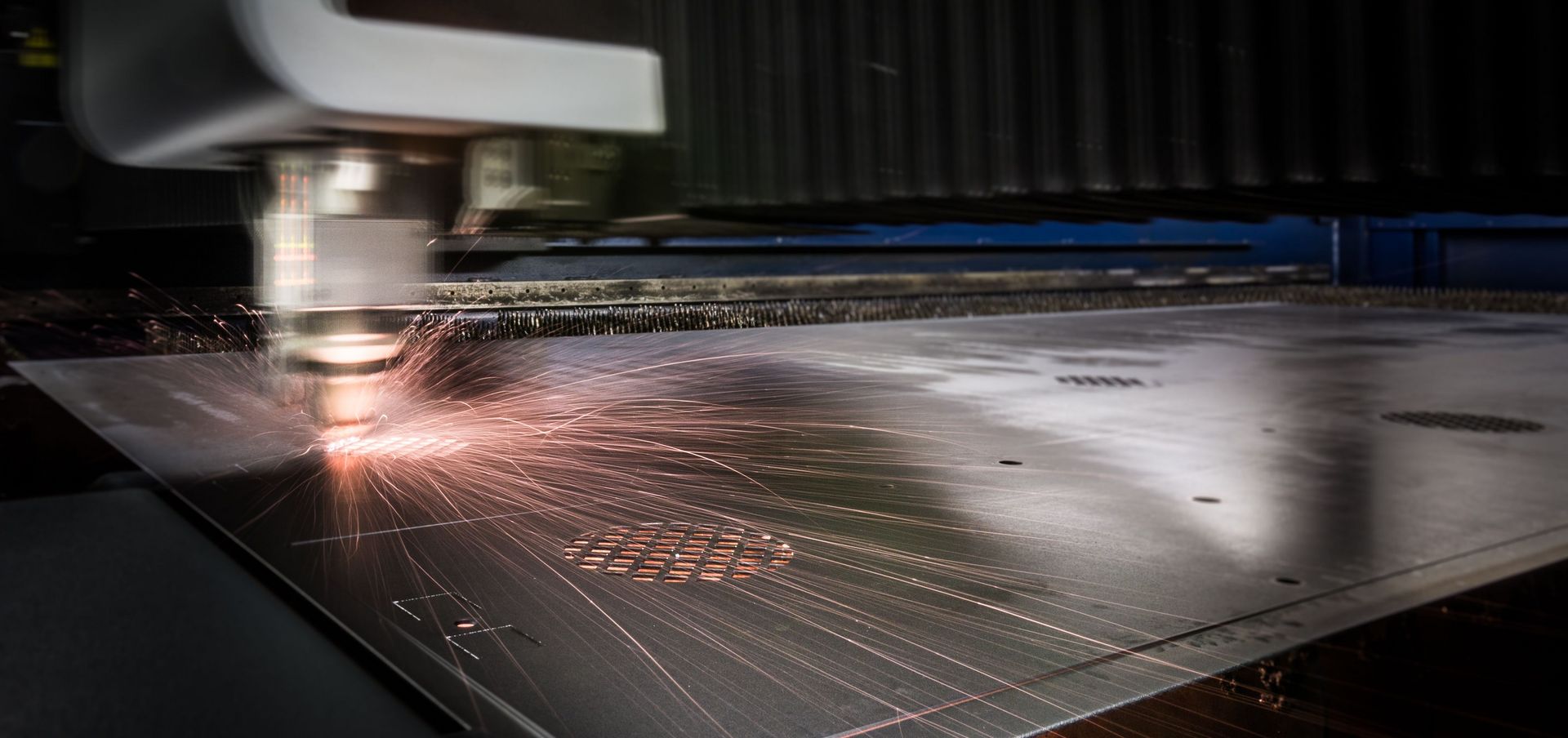

It was in 2011 that Neumann decided to purchase the TruLaser 5030 fiber, equipped with a 3-kilowatt TruDisk laser. The machine is flexible enough to cut thick  and thin-gauge material like copper and brass along with mild steel, stainless steel and aluminum. This diversity in utility is important for Neumann. “We have approximately 1,000 regular customers and, on average, serve about 330 clients in parallel, manufacturing a total of about 100,000 different items. The TruLaser 5030 fiber is just right for our needs, since it cuts extremely fast and has very low non-productive times, even for our short runs,” he explains. The fiber-guided, solid-state laser offers two outputs and this was definitely a factor in his decision. “This way we can use the beam source with an additional machine. And this was when we first thought about making our debut in laser welding.”

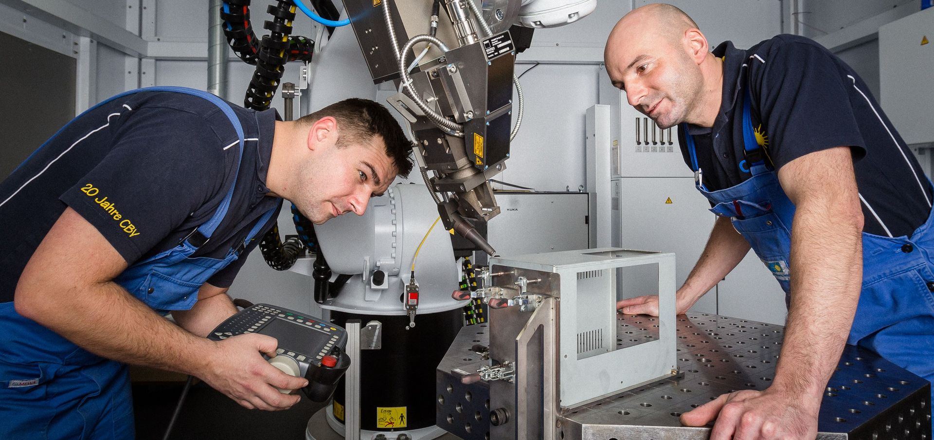

Daniel Voss, a welder at CBV, and design mechanic Marcus Hüttenrauch found their own ways to get the best from the TruLaser Robot, after a training session at TRUMPF. They shorten set-up times and costs by manually tracing the components in advance with the robot.
The TruLaser 5030 fiber is powered by a three-kilowatt TruDisk laser and cuts thick and thin sheets of copper and brass, as well as mild steel, stainless steel and aluminum. “It is extremely fast and the non-productive periods, even for our short production runs, are very low,” says Werner Neumann.

And in this aspect, too, pragmatism is prime. “My inventive workers quickly learned that they can save a huge amount of set-up time and cost when they use manual procedures to teach the robot when and where to weld. And before the welding itself starts, a measurement cycle under control of the TeachLine option detects variations of up to 20 millimeters and counters them to achieve dimensional precision. That works great,” he notes. About seven assemblies are worked completely without fixtures. The operators look for a zero point, use the symmetry of the hexagonal table, and simply trace along the parts.

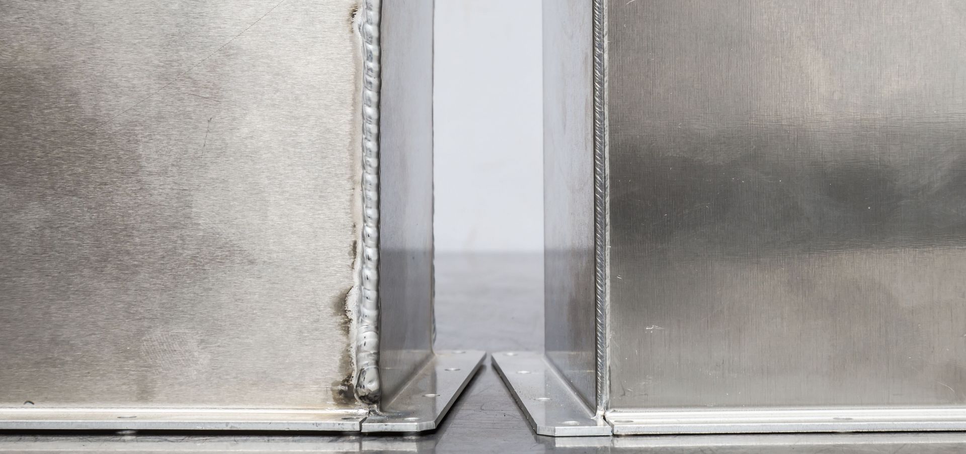

There are many examples of how productivity is increased. A batch of 100 parts, made of 0.8 millimeter aluminum – a material that is difficult to weld – required about twelve hours of touch-up work after manual welding. The TruLaser Robot reduced this to just 90 minutes. Then an edge, 30 millimeters wide, needed to be welded to a crowned housing panel made of stainless steel 2 millimeters thick. Here the touch-up time could be reduced by 90 percent. Neumann’s hopes of shortening touch-up periods have been completely fulfilled by laser welding.

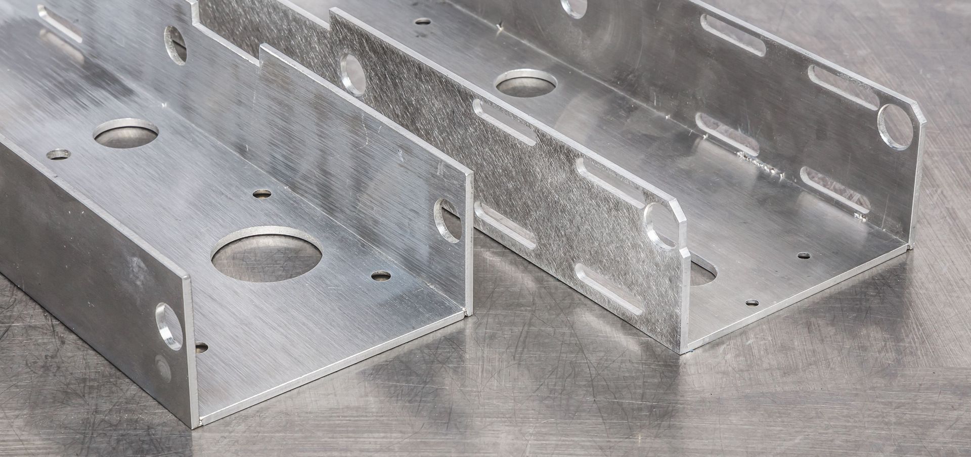

Here they count on our expertise right from the part design phase,” says Neumann. The best example is a U-shaped aluminum profile with close fit areas, holes and notches. In the past this was milled from solid material. “Now we cut the parts with the laser and deep-weld them at the base. Thanks to the low degree of thermal input, there is no distortion. We brush over the seams and thus save 95 percent of our previous costs. It goes without saying that the customer is thoroughly satisfied,” Neumann reports.
An aluminum U-shaped profile with close fit areas, holes and notches. In the past this was milled from solid material but now it is cut with the laser and joined at the base with deep welding. The savings, when compared with the previous costs, come to 95 percent.
Werner Neumann’s expectations in regard to the reduction in retouching work were satisfied completely by laser welding. For some parts the touch-up time could be reduced from twelve hours to just 90 minutes.
